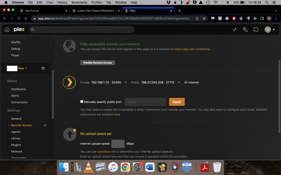

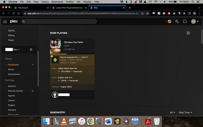

I’ve attached the most recent logs and some screenshots. The screenshots are taken from my computer, not the computer running the server. The computer is a Beelink Mini PC. The router is model is an SAX1V1S.
