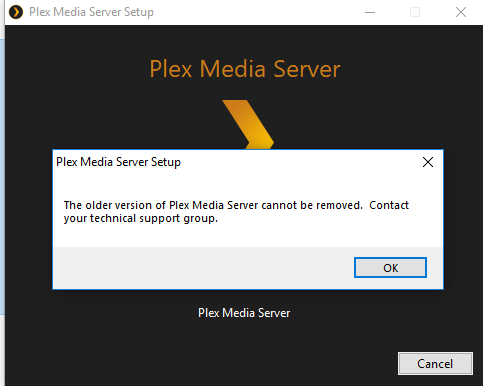

Install/upgrade not working. Missing PMS.MSI
I have tried to upgrade my plex. However it wasn’t able to do so, and I received an error;
I then decided to delete all of Plex from my computer, and run a complete fresh install. This included uninstalling, running the Microsoft Fixit program, and running Revo Uninstaller. I also did a search of the hard drive to manually delete any remaining folders/files that were associated with Plex.
Ran the install once again, and it continued with the above error. This has been ongoing for two days… Hell, I’ve even gone back and recovered my whole computer to last week in order to hopefully fix this (didn’t work).

So, I keep on trying anything that I find on this site… upgraded the .NET framework, continued to try installs, tried to remove all signs/files/innuendos/traces/everything to do with Plex, and start over… yet I continue to get the message that the older version of Plex can’t be removed (and therefore won’t load install).
This leaves me with a ton of media on my computer, yet no server to access it… meaning it’s useless to me.
Any other suggestions?

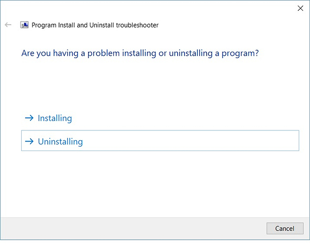

The Microsoft fix it should tidy up the version that does not uninstall
Try selecting troubleshooting uninstall of Plex Media Server
Plex Media Server has a number of packages - you may need to also try entering the package names
eg Stopping Plex for pms-shutdown.msi issues

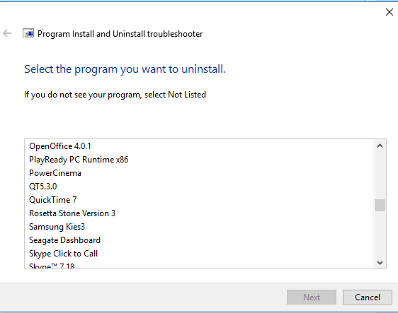

I have tried the microsoft fix, unfortunately the Plex Media Server (or anything to do with Plex) is not listed in the uninstall options.

What we could try is entering that product code into the Microsoft troubleshooter for install / uninstall
Selecting troubleshooting Uninstalling first
Then selecting Not Listed
and then on this screen entering the product code that shows in the above error log
{527EC40A-78B9-46DE-84BB-ADB8A3C51833}
and see if after this, you can install
If not, get all the new logs and zip and attach !
This final suggestion finally worked. I appreciate all of your assistance with this.
