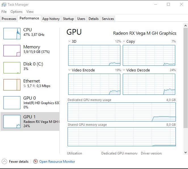

Hi everyone,
I just got my hands on the Hades Canyon NUC (NUC8i7HVK) with the Intel i7-8809G CPU that has the particular use of a dedicated AMD Radeon Vega M GH GPU on top of the Intel HD 630 Integrated Graphics.
Using hardware transcoding works just fine it’s just that it uses the AMD Vega dGPU instead of the Intel iGPU. I want to make use of Quick Sync (which from what I read is available for use, even though there are no display outputs connected to the iGPU) and so far I can’t seem to find a way.
Some other user around here used Windows 10 display settings to add PlexTranscoder.exe to use the Intel HD 630 but trying that for me it doesn’t seem to work, Plex falls back to software transcoding.
It seems people keep saying that even though no monitor can be connected to the iGPU, the Intel graphics CAN be used for OpenCL tasks and Quick Sync. I just can’t seem to find a way on how to do that.
Any help appreciated.
Windows 10 build 1809 with Intel DCH drivers (25.20+), iGPU enabled in bios set as primary?
Windows 10 build 1809 with Intel DCH driver, iGPU enabled, yes.
But there’s no setting anywhere to make the iGPU as primary display. By default the AMD dGPU is primary, and I can’t find a way to change that.
Attached is task manager with Plex transcoding using dGPU, as you can see, the Intel iGPU also shows in the list, it just doesn’t do anything.

OK so I did the thing you suggested and added Plexmediaserver.exe to the graphics performance profile, and no luck.
I then added both Plexmediaserver.exe AND PlexTranscoder.exe and that DID seem to make a difference. As seen in the attachment it now looks like the Intel iGPU is used for Video decoding.
I think this did the trick!!!
