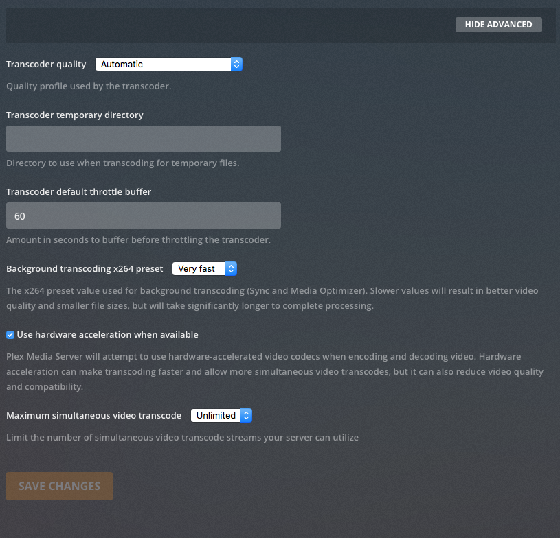

Did you click on Show Advanced under Settings | Transcoder?
@Achilles - yes, unfortunately after pressing “Show Advanced”, the “Use hardware…” option is not present.

@millercentral Did you claim the server with your plex.tv account yet? HW transcoding is a Plex Pass feature and requires you to sign it in.
Aha, I had not claimed the server yet – since I’m just testing, I didn’t want to expose other users to it. That could be it! I did not realize that could have an impact on hardware transcoding.

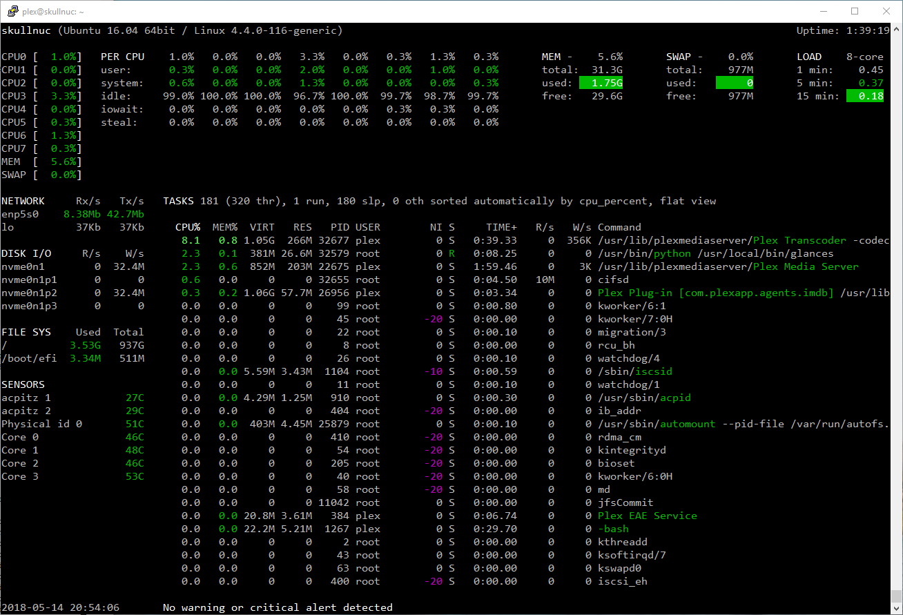

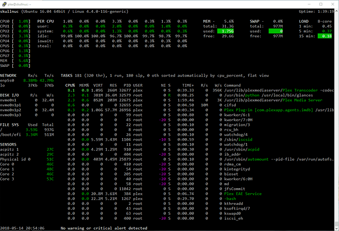

Success! @Achilles was spot on that without claiming the server, Hardware Transcoding was not available. When I re-setup linux on the device and this time claimed the server as part of Plex setup, the option appeared in Settings > Server > Transcoding, and works as expected. While I can’t see the status of the GPU block from linux, here is what glances reports while streaming and transcoding two 4K UHD rips simultaneously:
