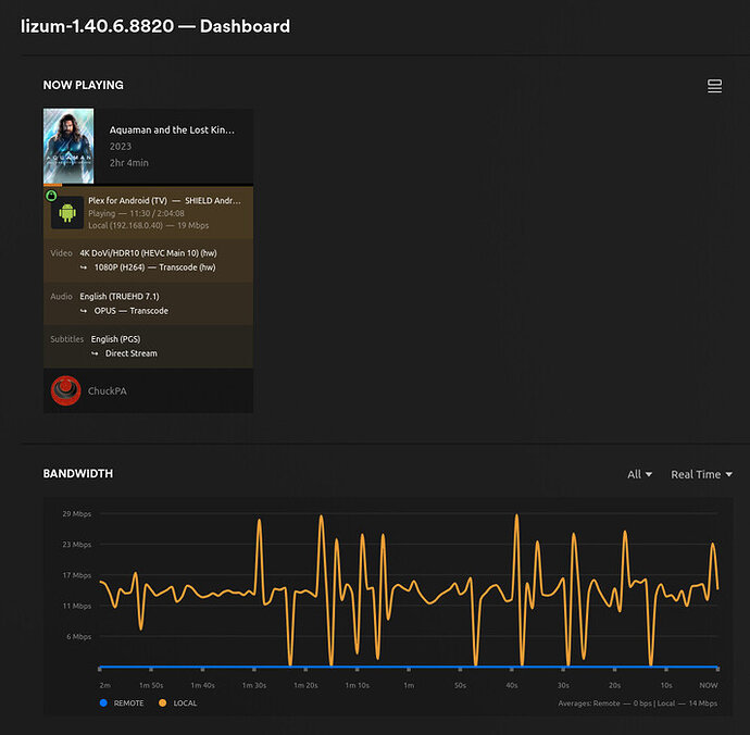

I cannot confirm the reported issues, THEREFORE …
I need logs and sample files…
I also need the XML of the files because while 3-4 Mbps looks great on a phone, it will absolutely look like S*** on a large screen TV (projection effect)
Followup:
Forcing transcode to 20 Mbps, with tonemapping, and audio conversion, on AlderLake (12th Gen). No difficulties so far.
