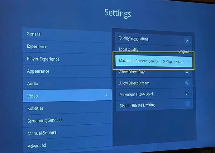

Related to the quality limiting settings - I was helping a family member with the Tizen Plex app on their Samsung TV over the holidays. None of the content would play unless the Maximum Remote Quality setting was explicitly defined.
Leaving this setting to Unlimited / Maximum would result in a spinning loading icon and the following errors. The stream would never start. The content being tested had a maximum bitrate of ~7mbps.
Between the server setting for limiting the bitrate to increase the quality, and the client not playing content unless this is explicitly defined, I have no idea what’s going on anymore.
