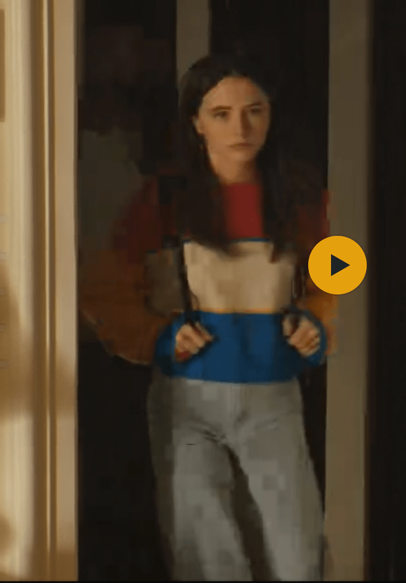

Intel Quick Sync transcode quality issues on Intel 12th/13th gen CPUs

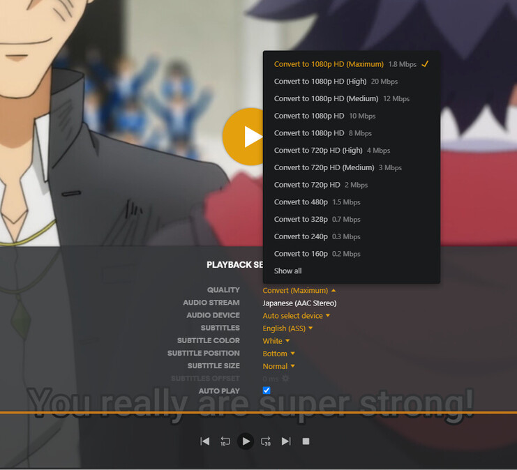

This should just be the installer downloaded from the plex site – not plex from the windows store app. It should function the same as the web client and allow you to select the playback quality.
As for your burned subtitles, does Edge support Direct Streaming ASS subtitles?
I’m actually not sure. I assumed it would since edge is Chromium based, but I could be wrong on that.
Anyway, I’m glad someone other than me was able to confirm, so I can strike out ‘getting unlucky with hardware’ as the root cause.
I have the correct Windows app and the same options as you. But when I choose 1080p or even 720p, the file continues to direct play since the bitrate is higher than the file. The only way to get it to transcode is to choose a resolution with a lower bitrate.

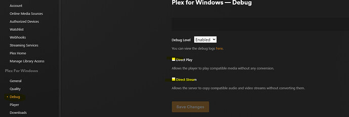

I also completely forgot I disabled direct play/stream manually in the desktop app settings:

  1. I played the sample you gave me. No artifacts
  2. I played a cut from my rip. Again, no artifacts.
Aside from us having similar taste in movies, :slight_smile:
I’m considering you have a hardware / firmware / cabling / HDMI port issue.
Folks are very quick to complain about PMS creating artifacts in their playback and this is the only case I know of.

I had no idea there was an option to turn off Direct Play/Stream on the Windows app. I prefer Direct Play so it never occurred to me the option existed.
I turned off Direct Play/Stream and can confirm that the pixelation does not occur in the Windows app when transcoding 1080P HEVC to 1080P H264.
