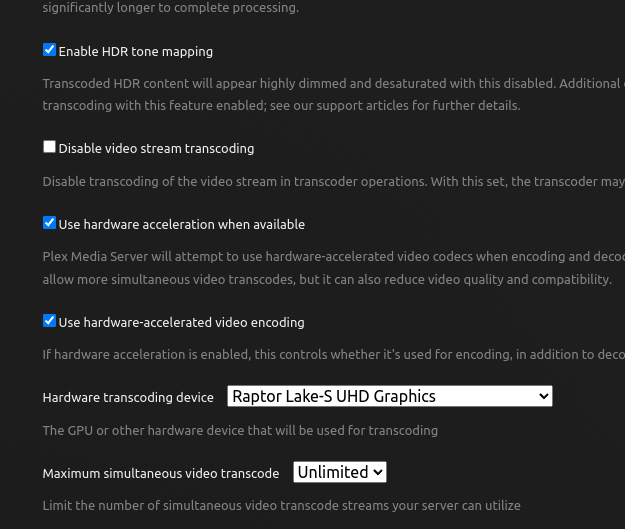

OK, this all works for me again.
To your questions:
  1. Everything, including RaptorLake, is supported for QSV transcoding.
  2. RaptorLake CPUs have a Linux deficiency regarding the CPU itself (p/e cores, etc) which is supposed to be fixed in 6.2 kernel.

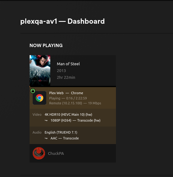

chuck@plexqa-av1:~$ cat /proc/cpuinfo | grep 'model name' | uniq
model name	: 13th Gen Intel(R) Core(TM) i5-13400
chuck@plexqa-av1:~$
As I show above, My output bitrate is 19 Mbps video.
What is your video output bitrate ??
