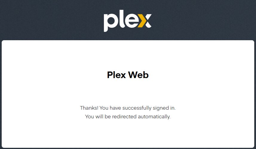

Internal server error; sometging went wrong on our end message when trying to log in
Server Version#: 1.42.2.10156-f373b826c
I’m having the same issue from different computers.

just logged in for me after 20 minutes trying and getting this, even though I got the ‘New sign-in to your Plex account’ email
