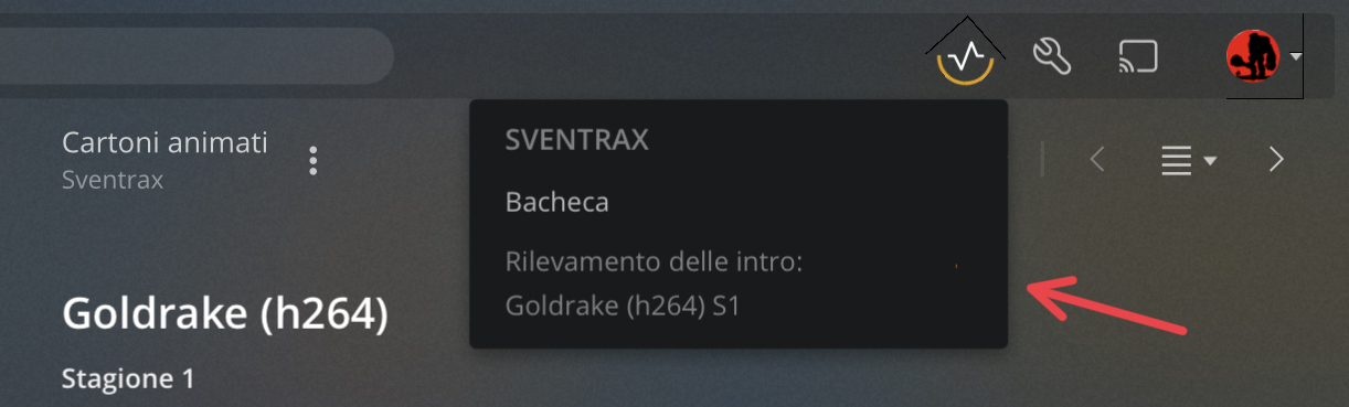

I pressed “analyze” on my libraries and it got stuck on “detecting intro: [random serie]” without any progress bar for more than 20 hours.
I restarted my NAS and everything seemed ok (well, at least nothing started to process). I clicked “analyze” on some of my tv series and it ended immediately, no idea if it was really analyzed or not. I started to watch one and no “skip intro” appeared.
Then I added a new season of a serie and now it’s stuck on detecting intro since hours and I don’t know what to do.

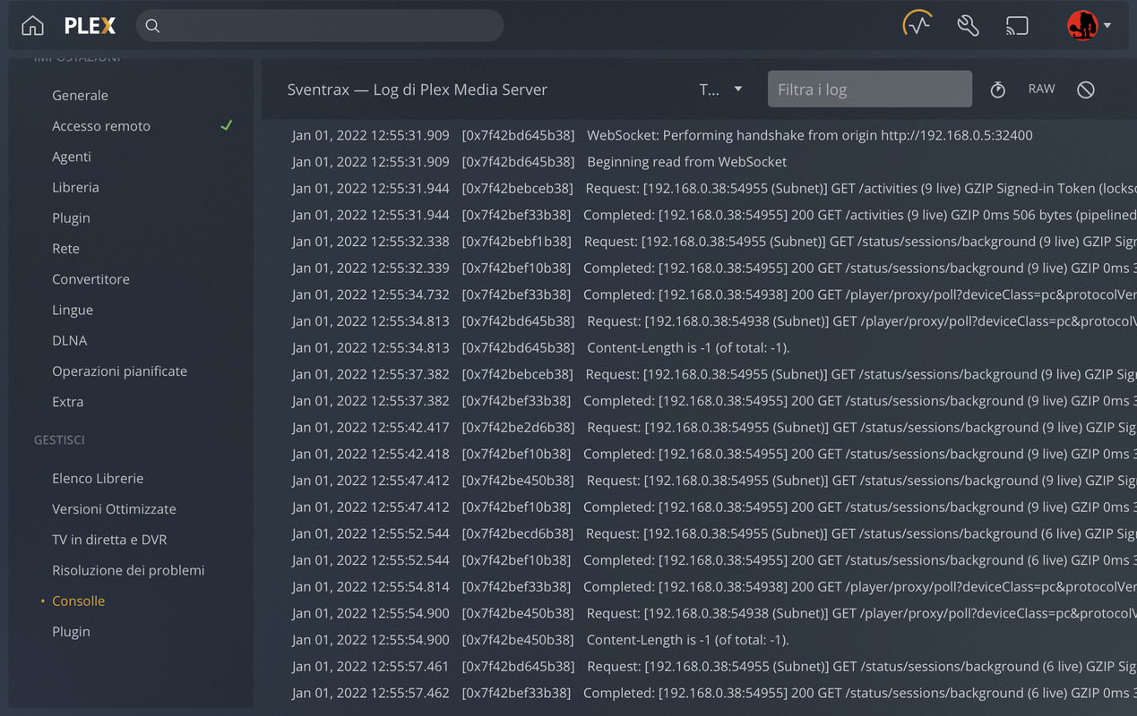

I still didn’t understand where I can see the log of what the server is doing, all I’m able to see is the “consolle” that shows me strange debug info, but I don’t think they’re related to the skip intro feature:
server logs
You should be able to download the logs from Risoluzione der problemi

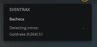

Update to the progress: now we’re almost at 4 hours and the progress bar is still at the same one tiny pixel of the previous image. Should I get worried? You said it should take “several minutes”. Now my NAS is not a Powerful PC but, if this is just 1% of the total (on a single season), it means it could take almost three weeks.
If this is the expected processing time, I guess Plex Pass is not for me. O_O

So far, about 6 hours later, the orange pixel doubled, so it’s around 2%:
I guess something’s going wrong. And no idea how to check the logs, as it’s like 10-15 files. :frowning:

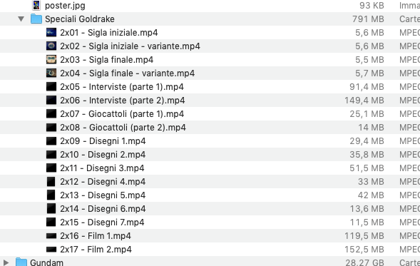

I’ve noticed you’ve placed all episodes in 1 flat folder per show.
Could you try reorganizing this one show to match the naming schema used for Plex to see if this helps speeding things up? With all files in a single folder, Plex will compare the sound prints of all those files instead of only those in the same season… this is multiplying the workload (and can slow things down significantly).

I always try to follow Plex structure, but in case of old cartoons (this one is 1975), most of them where just one season, with tons of episodes, in this case 74:
Goldrake-folder
The folder “Speciali Goldrake” is a custom one with some featurettes, that I organized as it was a second season (but it doesn’t exist in tv show databases):
