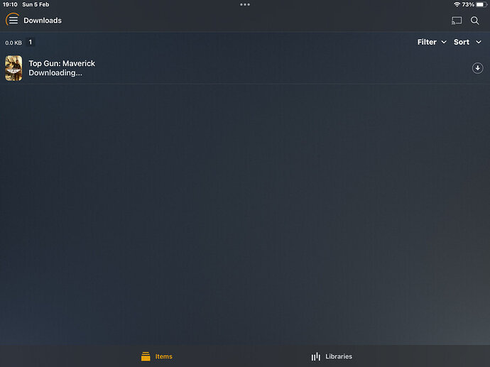

iOS downloads not working
Server Version#: 4.87.2
Player Version#: 8.14
Has anyone recently had issues with tying to download content from their Plex server to an iOS device. I have tried to download content for an upcoming trip to watch on the plane. However all of the devices seem to be stuck and refuses to download.
Has anyone got any fixes please?
What is your server doing at that time? Transcoding? How much time did you gave your iOS device?
maybe in a plane Top Gun is not the best movie to watch?
Myself and my wife tried to download earlier in the week and she just noticed that it hadn’t downloaded. Obvs we have different things to download so that rules out that it’s a particular issue with that video.
Also tried rebooting server and not sorted the issue. Seems to be an issue run iOS app.
