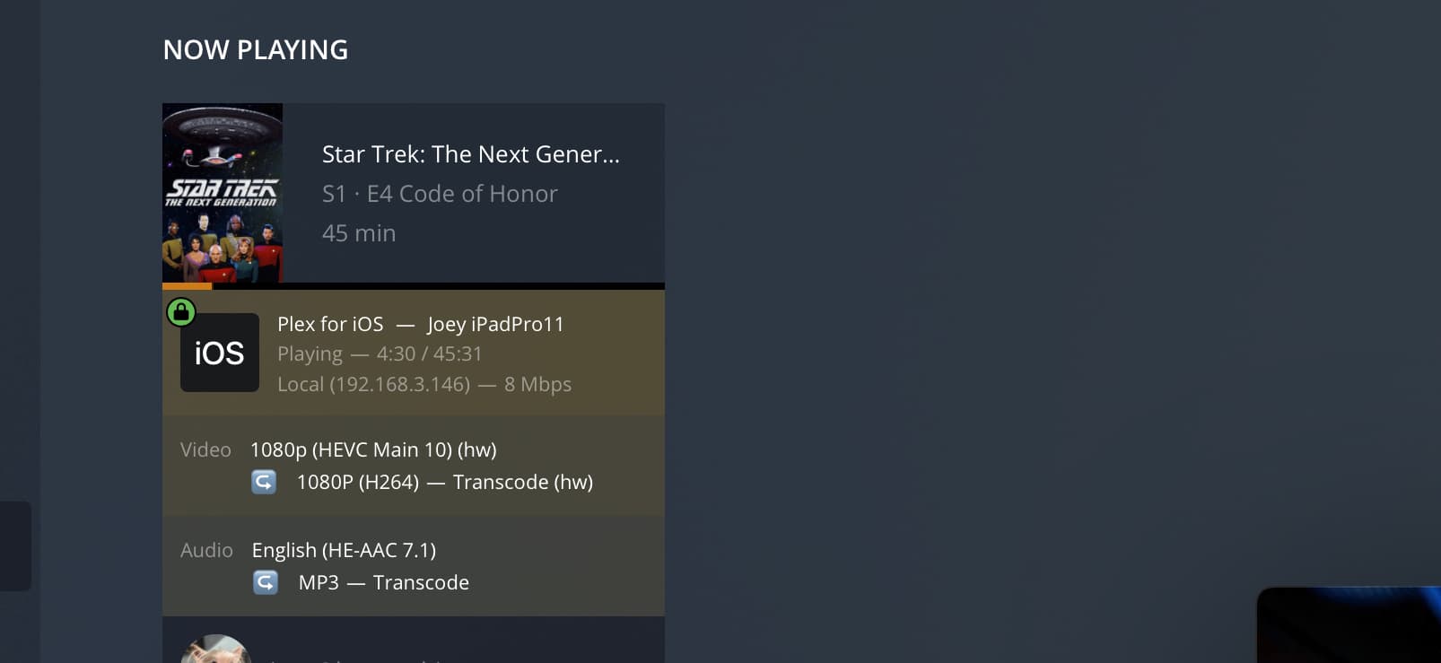

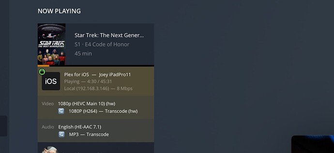

With the latest iOS app update (7.28) and current server server version (1.25.4.5487), the issue is finally resolved!! :grinning:
Seems like the app finally requests the proper transcode compatible with the classic player used by PiP mode.
Here is how it plays successfully now:
