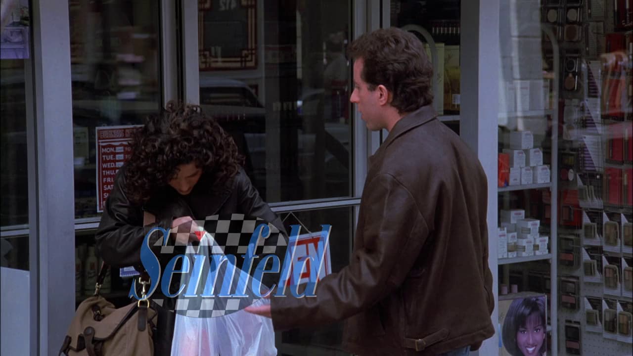

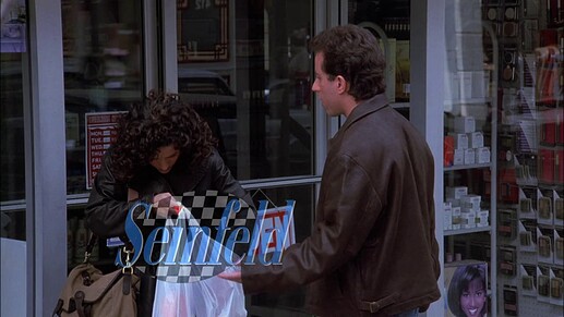

@ChuckPa @herman_munster
I grabbed the Seinfeld example, and mine does the exact same thing.
Running 2019 Shield Pro, with 8.24.0.28335 and 1.24.4.5081.
Here’s a video of me watching the video:
IMG_1728.MOV.zip (14.8 MB)
Watch it on my iPad, iPhone or MacBook, all work fine.
Test-4 and Test-5 started with no issues.
In your video showing the problem, the image starts out frozen on frame 120, the second I-frame in the video file. That should be at 5 seconds in. Video playback resumes when it passes that point.
