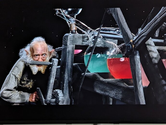

Behavior 3 - Pixelation/Tone Mapping Issues on Video Playback
An example of this while playing “The NeverEnding Story”
Then a few seconds later but within the same scene:

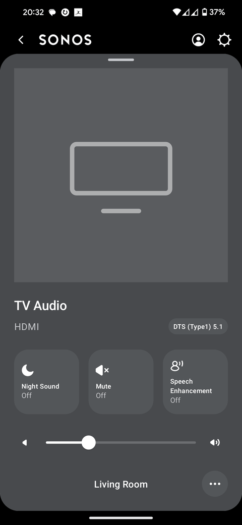

How your Sonos Arc play DTS-HD?

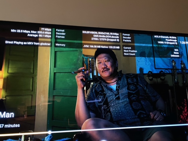

As far as I am aware, no. Can’t tell now based on that time frame, but, replaying the file, it occurs again on the nVidia Sheild Pro 2019. Something did happen, and the network throughput peaked at 700 MB - which seems unlikely given that I don’t have 10GB LAN Connections. I also can’t get the Display Video Overlay info to show when playing the video like you have on your screen for what it is worth - even when the setting is “On”.

I can play Gemini Man with subs , dolby, the works, perfectly at 59.94 FPS too.
Might you have shield player logs which capture any of it failing?
