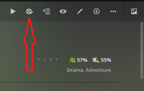

I just tried it and it appears to work for me. Please note that when there is only 1 trailer, you won’t get the extra hub. There will be a “Play trailer” button at the top.
Awesome, thanks for the checking it out and getting back to me promptly!
So is it working this way for you? Just want to confirm that you were looking for the hub which won’t be there, but that the trailer is still available through the icon above.
I usually have a local trailer as well as the downloaded ones, so the hub is almost always visible, because there are two trailers. I DID know that if there is only one extra, and it’s a trailer, the hub disappears, but completely overlooked that when I tried that option. My bad!
