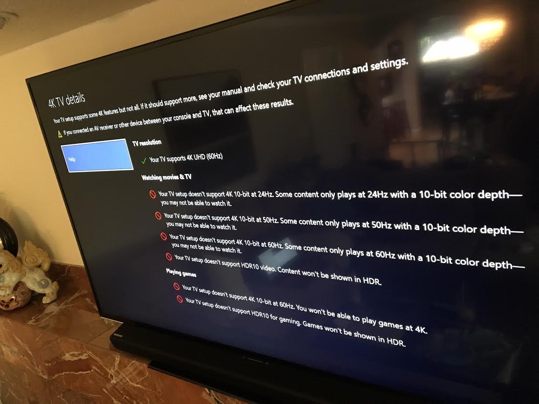

I’ll update on my findings ! One interesting note that I’ve found: the HDM1 port of my Samsung TV (UN55HU6840) labeled STB, when enabling UHD Color on the port, claims to support 4k at all resolutions, however none of the Apps (Netflix/Amazon) recognize 4k. After calling Samsung support, they recommended using the MHL port, which according the Xbox console settings does NOT support any alternate 4k resolutions, but the Apps (Netflix at least) DO recognize it and I’ve been able to stream 4k there. Plex/Mediaplayer both appear to have the same issue with this green screen however.

What model of Samsung do you have doofologist? I have the UE48JU6500, and I just today received my Xbox One S. I was worried at first because for some reason the console default to “DVI” mode, so I set it to HDMI. Then it kept telling me my TV did not support 4K. Then I read a note saying that the console will only detect all the 4K features properly (including the confusingly named UHD Color option, why they couldn’t just call it HDR I’m not sure) if the port type is set to auto-detect. Strangely enough that fixed it, and now all my TV features are detected by the console and Netflix runs at 4K just fine.

@Ryster I’ve got UN55HU6840; if you see the below screenshot, this is the compatibility from the Samsung recommended MHL HDMI port (HDMI3). While it looks like it wouldn’t work, this is the only port that Netflix recognized 4k (and currently works with). Using any other port with UHD Color enabled looks like your screenshot (except HDR, which my model doesn’t support), except that literally nothing recognizes 4k other than the dashboard.
