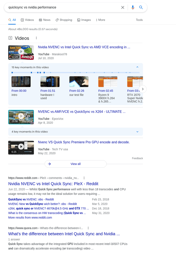

I’m sorry to disagree but a single hit on google yields an insane amount of results.
Within the first page are some heavy hitters.
There is a great deal of technical discussion on the Reddit links.
