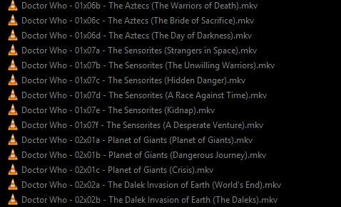

Wondering about a quick solution here. This is my current naming convention and I have a bulk rename utility. My head hurts and some help would be greatly appreciated.
Well, that won’t work.
  1. your file names are not in compliance with Plex Naming Standards for TV Shows.
  2. your naming isn’t in compliance with TBDB’s method of listing Doctor Who Episodes
  3. you can get away with #2, but #1 MUST be in compliance. Period.
Here is a perfect example of both Plex and TVDB compliance, starting at Season 2:

Now, let’s stay in compliance with Plex and call the episodes what you want:
A TV Show Library/
…Doctor Who/
…Season 02/
…Doctor Who - S02E01 - Planet of Giants (Planet of Giants).mkv
…Doctor Who - S02E02 - Planet of Giants (Dangerous Journey),mkv
You can call the episodes whatever you want. Everything after ‘S02E01 -’ is ignored by Plex. You MUST however be in compliance with: ‘Doctor Who - S02E01 -’ (the hyphens can be nixed, but the guideline below shows them in. Filebot puts them in when it names files perfectly for Plex, so I’m showing them in 'cause they’re in over here and I’m the guy with no errors in his log file. Read into that whatever you like, but I can see that Bulk Rename is at least getting the Show Name and Hyphens right, but has failed miserably at everything else. Try FileBot instead (link in my signature).
