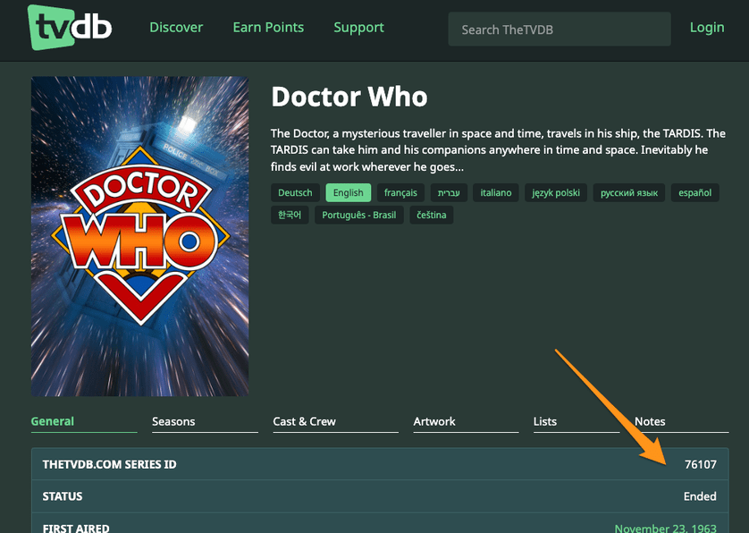

The ID will be on the main page for the show on TVDB
You also have to tell Plex you are using TVDB is that what you are basing file names in either the library or you can override individual shows. By default Plex users TMDB not TVDB

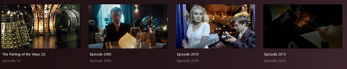

Season 01, for example, is showing correctly in that it has the shows for that season, but it has an additional three specials that aren’t even in the same folder. They’re in the “Season 00” folder. The files are named like this:
Doctor Who (2005) {tvdb-10152809} The Church on Ruby Road
Plex can’t deal with that. That’s why I’m thinking each special has to be in a separate folder. Sadly, I just finished renaming all the special files. I posted here because I’m hoping I won’t have to do it all over again. Apparently, I will, unless someone has a better way to do it.
Here’s an example. The first show is correct. The other three don’t belong.

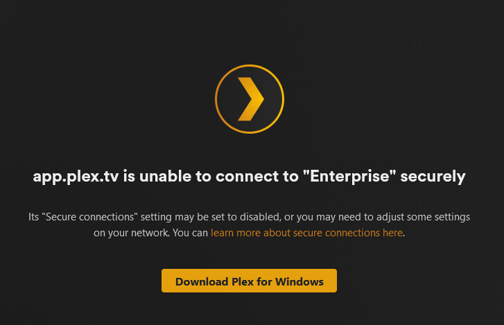

Crap! Now I’m getting this.
Why did this happen?
The computer is okay. I’m using Remote Desktop to work on it, so it’s working. It just completely crashed and is acting like it isn’t even installed.
Now what do I do?
I restarted the computer and Plex is working again. Maybe Plex benefited from a reset and several hours overnight.
