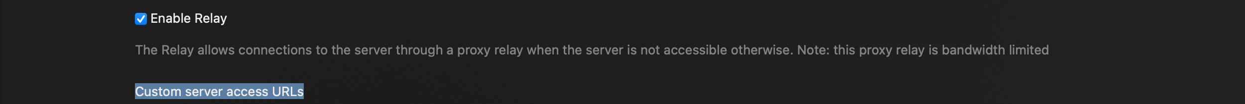

Go to ‘Network’ in settings. There’s an option to set your own custom domain.
Hi @Krazeh, I believe you’re referring to Custom server access URLs, correct?
The issue I’m encountering is that when I specify a custom URL, it doesn’t function as expected because it requires an HTTPS connection with valid custom certificates. If the certificate is invalid, the URL isn’t utilized.
What I was hoping for is that the URL would be used to detect the public IP. I tried using my XXX.duckdns.org address, but this caused an issue where app.ples.tv didn’t allow streaming in higher quality—it wasn’t using the direct connection.
If your real public IP is, for example, 203.0.113.100 and the port you’re forwarding externally is the Plex default of 32400, enter the following for your custom server access URL:
http://203.0.113.100:32400
Plex will automatically convert this into one their secure *.plex.direct connection URLs. So, for example, the above will become:
https://203-0-113-100.certificateuuid.plex.direct:32400
