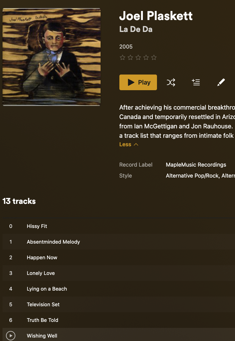

Firstly, this album: Release “La De Da” by Joel Plaskett - MusicBrainz
Has two track 1s:
The pregrap track isn’t even first, though.

Heya! Thanks for replying.
When I say it has two track 1s, I meant that it’s not supposed to, actually. It shows up that way in Plex, which is what I don’t understand.
The pregap track is numbered 0 in my files, as it should be.

It works fine here. how are you naming/tagging your files?
i use musicbrainz picard for tagging and naming as per the plex guidelines…
/MUSIC/Joel Plaskett/La De Da (2005)/00 - Hissy Fit.mp3
/MUSIC/Joel Plaskett/La De Da (2005)/01 - Absentminded Melody.mp3
Thanks for replying!
All of my files are tagged with Picard. I use $num(%_absolutetracknumber%,2) for track naming, so it will start with 01 in the filename, but the track metadata clearly states track 0.
