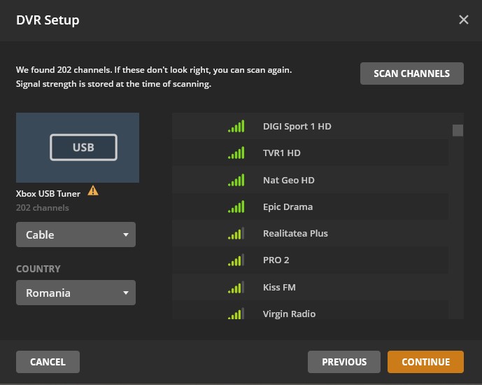

For one of my other projects i purchased an XBOX TV Tuner and I tried to see if it worked with linux and plex.
To my surprise this “UNSUPPORTED” tuner got further with my plex setup than the “SUPPORTED” one.
Basically after choosing the same profile with the xbox tuner, plex went ahead and found all the channels with their correct names.
Screenshot 2020-10-16 113950

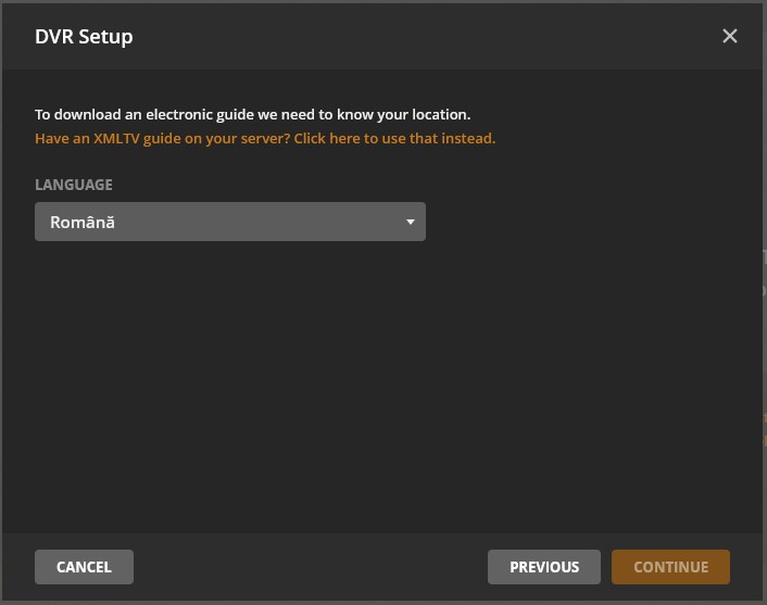

However it got stuck in the next step:
Where it asks for the language for EPG. Whatever I value I chose in the dropdown box I could not add continue to this form:
