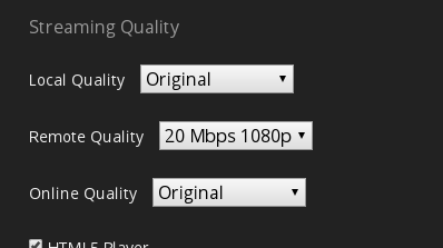

Check your playback quality setting. Settings - Web - Player

Playback settings are set to Original, and I am having the issue with Shield TV and iOS app.
