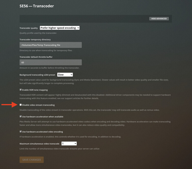

Try toggling off this setting in Server transcoder settings
