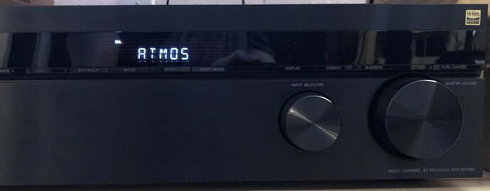

If the combination of LG 65C9 OLED & Sony STR-DH790 truly pass unmodified truehd+atmos, I would like screen shots of the plexweb status, and a picture of the receiver with truehd+atmos indicators lit up.

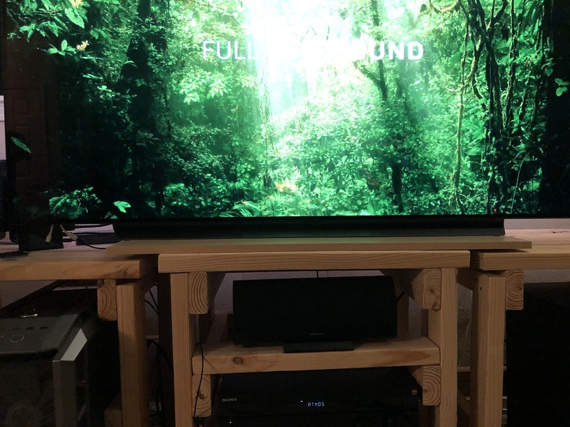

OK, I reconfigured my speakers to 3.1.2 and was able to get ATMOS to display on my AVR using both 1) the LG TV’s built in Disney+ app playing Empire Strikes Back, and 2) using the Shield Pro to play the Dolby_Amaze_Lossless-ATMOS-thedigitaltheater.mkv file from the Dolby Trailers page I linked earlier. It says the file has Dolby TrueHD 7.1 ATMOS.
Here are the photos:
The Plex dashboard doesn’t specifically say ATMOS so I’m not sure if that means anything.
Also, the receiver display scrolled through the text “DOLBY ATMOS - DOLBY TRUEHD” and then settled on displaying ATMOS after the scrolling was complete.
Is that a successful test? I know these things can be more complicated than they seem.

looks good to me, thanks for the confirmation.
plex itself doesn’t display ‘atmos’ anywhere.
so we now know that SHIELD will work over E-ARC with compatible tv/avr.
