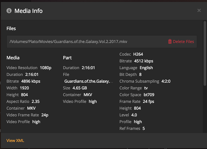

- Details of the media (Get Info -> View XML), use of subtitles, etc

So yeah based on that you need 4.5mbps to stream that file and 1Gig is plenty.

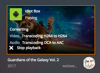

I don’t know why, but yes, it is transcoding, even though I have Direct Play enabled.
The television apparently does not support MKV natively so transcode (container change) to MP4 is required.
Audio is being converted from multi-channel to, most likely, 2 channel because the TV likely doesn’t accept 7.1 in it’s current config
Regardin network demand. that’s a composite, audio + video of approx 6 Mbps

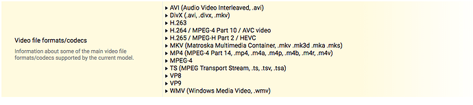

The TV does support .mkv natively; no transcode required (see attached pic) and the audio is not playing through the TV but through an ARCAM 5.1 AV receiver. The TV itself supports Dolby Digital Plus and DTS Premium sound, so I can’t imagine why it would transcode to 2.0

4.5 Mbps * 1.2 (20% TCP/IP overhead) = 5.4 Mbps.
I do not see what the Audio is to estimated you’d havev 256 KB / channel of stereo → ~6.0 Mbps combined payload

You previously showed the media info.
Would you please go back to that screen and click View XML and share what it reports here? That will be the definitive information about what PMS sees and why it makes the decisions it does

i did notice something odd, though. The files playing through the Roku are Direct Play, while those using the Android TV interface are all being transcoded.
