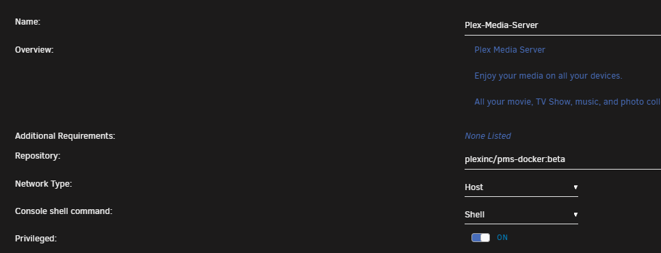

Tried executing in privledge mode and now all is good
Logs are fine too

what are you running, that gives you the repo ‘management’ gui in your screencap?
