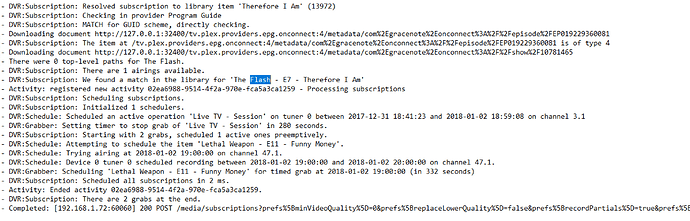

I am attempting to record two shows at once with my HDHR Extend (2 Tuners). When I set the second recording.. It shows up in “Starting Soon” and I get this.
Then under “Recordings Schedule” it says this
The only relevant part of the log is this.
Message says that a match was found in your library. Since a match was found the recording priority would show no upcoming recordings. The program guide will still show that the episode is scheduled to air.
Thanks I see that now, I thought that meant that it found a match of the recording record… not in my library… makes complete sense now.
