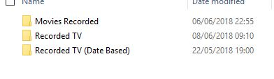

These are the folders i have for my recordings
2 TV based ones, Recorded TV & Recorded TV (Date Based)
Recorded TV - This is just a standard TV Library setup with the defaults, so anything i select to record into here does a lookup on tvdb
Recorded TV( Date Based) - Similar to the above, but i have set the agent to Personal Media Shows, anything i record into this one, tvdb is ignored, the metadata only comes from the epg data

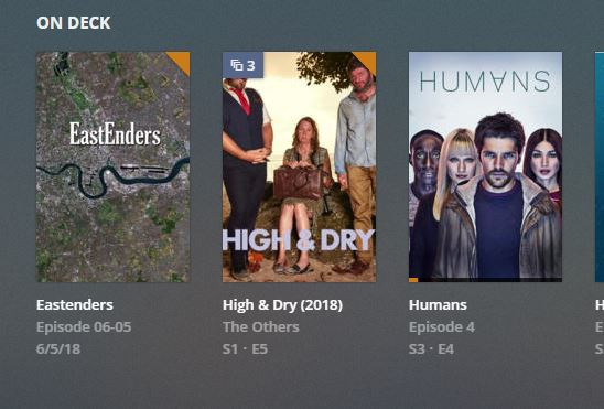

This is what i see when i view plex
Eastenders has been recorded to the one with Date Based at the end - this metadata is from the epg, nothing from tvdb
The other 2 recordings whhere recorded into the other directory, both have data from tvdb

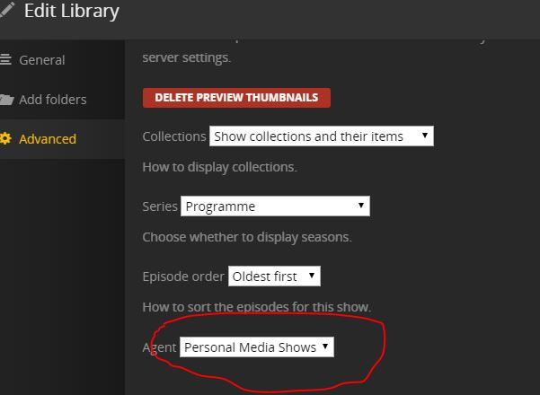

The steps for you to test it
1, Create a new folder for the shows you dont want matched
2, In Plex, add a new TV library, add the folder you just added as its location, then from the advanced option change the agent from tvdb to personal media shows
3, deleted the schedule for a wrong show
4, re schedule the show to record and select the new library as the location to record to
5, check when recorded and it should only have epg data as the metadata
