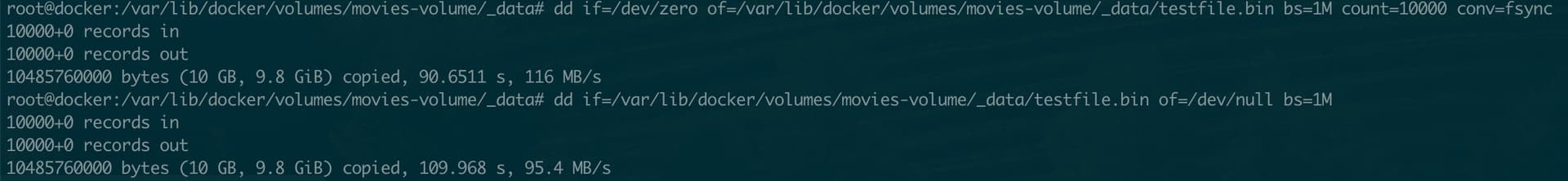

Thanks for that suggestion @ChuckPa! I hadn’t thought of testing NFS inside the container. Definitely appreciated. Test doesn’t seem to show it is slower within the container versus directly.
Here is directly (write: 116 / read: 95.4):
Here is inside the plex container (write: 115 / read:101):
Here is an iperf3 test from the QNAP NAS to the nvidia shieldtv pro to show the whole path:
Let me know if you’d like anything additional on this direction or if you’d still like to see debug logs and I can grab them.

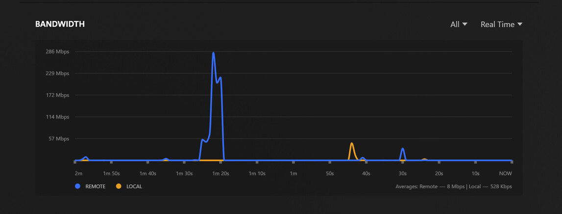

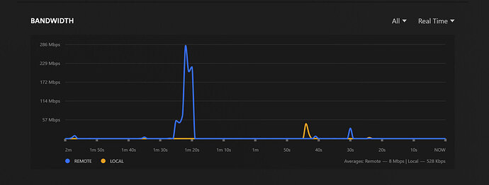

@ChuckPa - New device arrived today, I will get it setup and test tomorrow. But wanted to ask you to review a new set of logs after I just ran into the problem. It took about 20 seconds to start and I was able to grab the logs shortly after. I’ve attached the logs and a few screenshots of the dashboard.
The dashboard show’s it as direct play, but shouldn’t I need to transcode if it is HDR?
Plex Media Server Logs_2024-08-07_21-31-44.zip (3.9 MB)
Alright, new NUC is installed and running. Concerning part from the log I uploaded in the previous post:
Aug 07, 2024 21:30:38.996 [140517867064120] DEBUG - Failed to stream media, client probably disconnected after 65536 bytes: 32 - Broken pipe
<redacted>
Aug 07, 2024 21:30:38.996 [140517864954680] DEBUG - Failed to stream media, client probably disconnected after 65536 bytes: 32 - Broken pipe
<redacted>
Aug 07, 2024 21:30:47.174 [140517867064120] DEBUG - Failed to stream media, client probably disconnected after 638976 bytes: 32 - Broken pipe
That period (21:30:38 - 21:30:47) seems like it would match-up with the lag that I experienced. Looking forward to your feedback @ChuckPa .
