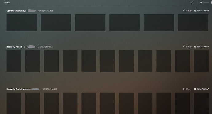

I’m hoping someone can shed some light on some performance problems I’ve been having with Plex.
During normal operating situations, Plex runs fine. If I try to empty trash when there are some deleted tv series it will essentially lock up plex for several minutes, sometimes as long as 15 minutes. If I let it run (which I almost always do) it will eventually return to normal operation, but it times out all streaming users and causes any browsing users to see an unreachable retry error.
