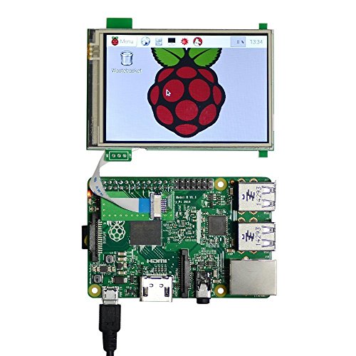

Hi!
I bought this Tontec 3.5 screen.
There is some manipulation to enabled it as primary screen. The HDMI screen is primary so I have to switch it.
The problem is that the tutorial given in the box is for Raspbian and there are some changes.
I have to change config.txt. The file wasn’t in the same folder but I find it.
So, i have to change /usr/share/X11/xorg.conf.d/99-fbturbo.conf and for now I didn’t find it.
In this file, I have to change the primary screen.
How can i find this file ? I try a FIND command but it doesn’t exist.
Anybody find a solution for Rasplex and a LCD display ?
Is that possible to install a Plex client on Raspbian ? Maybe it will be more easy for me ?
Thanks a lot.
Rasplex has no X environment, that why you can’t find it, it doesn’t need it.
There are some old posts relating to touchscreen so, no one has got one working as far as I can remember, Rasplex doesn’t support touch, but the screen should work, suggest searching this section for ‘touchscreen’.

Ok. Thank you for your answer.
The touchscreen function is not a priority. I have search for many solution to have the LCD display working with Rasplex but I don’t find it yet. The screen works on Raspbian but there isn’t Plex client on it.
If anybody have a solution for this : Plex client on Raspberry + LCD screen working, I take it !

So, for now there is no solution to use Rasplex or anything similar Plex client with a LCD screen on Raspberry Pi.
