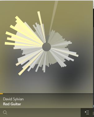

WOW thanks for the hint regarding the soundprint visualizer. This is crazy! I just recently bought a couple of remastered albums from iTunes as my old records (I digitalized years ago) sounded “weak” in each mix (due to loudness war). I was aware of the underlying basic problem loving PlexAmp for this reason. However it wasn’t clear to me how huge the differences are. Look at one example: Remastered Red Guitar track from David Sylvian 2009 vs. original track from the record of 1984. The complete dynamic of the song - especially that the last refrain is much louder than the first ones - is completely removed and flattened in the remasterd version. ! Holy Crap !
old Remastered
Yep. You could say it now sounds just like it looks - boring.
