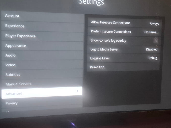

Make sure your settings are the same, allowing your Server LAN IP.
LG Tv
Your Server:
It can also be advisable if your router allows to Reserve your ServerLAN IP address for your Ethernet. Restart your Router, Server and TV.

Have you got the first screenshot settings correct. Thats a must.
Do you mean the Advanced Settings to allow insecure connections and those? I haven’t changed them between LAN and WiFi, and it works on WiFi with the same network, it just does not work on wired LAN.
Make sure there as i demonstrated
Yes, the settings are correct. As mentioned before, it’s working on WiFi but not on wired LAN. Do the logs indicate why, or do you need more details or more logs?
