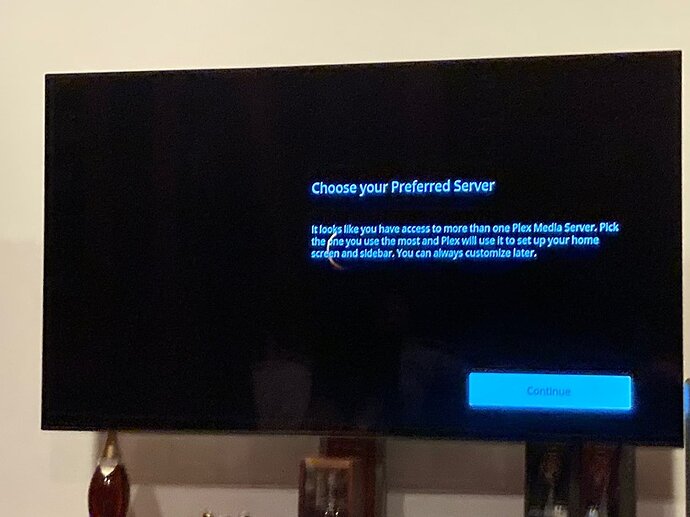

I have an LG TV at a family members house a few miles from me that was connected to my Plex server remotely via a separate Plex account I shared some libraries with. Worked fine for months. My server got corrupted and I had to rebuild it a few weeks ago. The server name is the same as before and all is well working on most of my clients and even my phone when I’m not home so it’s not a remote access issue. But, I can’t connect on this TV that is also remote. Other apps like Netflix are able to connect fine.
I tried uninstalling the app and reinstalling it and even doing a “reset“ from within the app, but it still doesn’t work.
I went into my Plex account and deleted the device under authorized devices. Even though I can log off of this Plex account and log back in, it does not see the actual server. It times out while looking for it and then ultimately just shows the Plex provided content.
Any thoughts are appreciated!

His ACCOUNT is now working, but only on his laptop. The TV is still doing the same thing. I told him to sign out, delete the app, shut the TV off and let it sit unplugged for an hour then re-do everything. We’ll see what happens…
