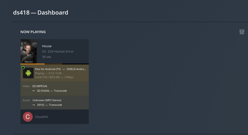

This is tough to see but that sample playes from my DS418j (aarch64/armv8)
to my Shield Pro 2019.
The file must be transcoded because of the XViD codec.
FYI: Fewer and fewer support XVID. It is dying. it’s time to let go of it
This isn’t plex. This is actually the underlying Nvidia Shield not supporting it.
The Plex app asks the Shield if it can DirectPlay.
It responds with NO.
PMS transcodes.
As confirmation. I recommend converting this to full H.264 instead of the current MPEG/XviD codec.
It’ll directplay after that.
In the end, this has nothing to do with SRT subtitles.
It has everything to do with the XVID (not H264) encoding.
