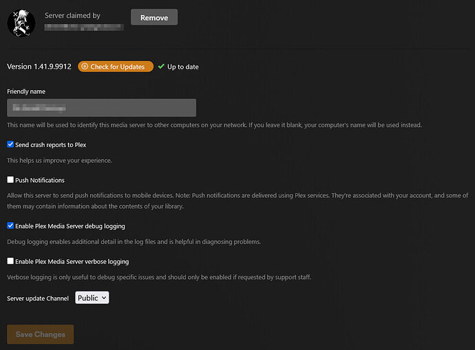

@Klaas_Ann-Sophie
Have you considered doing a manual cleaning/fixing of the DB ?
Yes, but I want to reserve some time for that to fully concentrate to avoid making mistakes so that is a job for this weekend :slight_smile:
Is the script different form what Plex is doing with the optimization?
Sidenote: I’m using the docker plexinc/pms-docker:plexpass and the setting Server update Channel is set to Public but it seems that I’m running the latest Beta?
I don’t know why it’s pulling beta versus public but you can specify which version-build you want the container to use. (which I always do)
( did you specify ‘latest’ and have your account settings for ‘beta’ channel ? )

The :plexpass tag was deprecated 4 years ago. It automatically installs the beta version.
https://hub.docker.com/r/plexinc/pms-docker/tags?name=plexpass
The “Server update channel” setting is irrelevant for the docker container. The installed version is dictated by the docker image tag. See the latest readme for the available tags.
