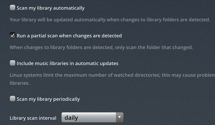

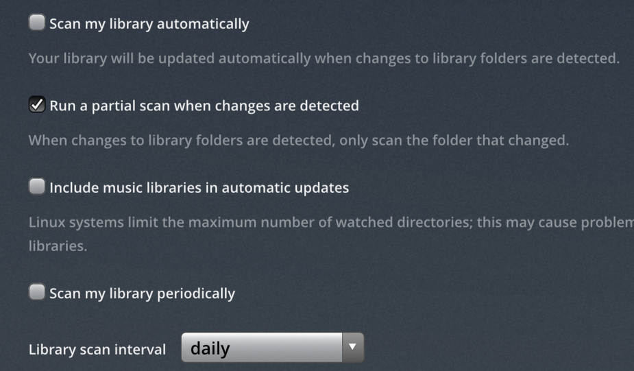

Is this the ideal settings then? Will a partial scan still be ran even though update automatically is turned off?
Something I noticed though is there is a lot of processing being done with these constant library updates. Generally when I ran an update manually it’d be SUPER quick and be done within seconds. When this update polls though it takes forever and seems to be reupdating all of the metadata as well as rearranging the recently added deck. Old movies are being re-added as “recently added”
Scan automatically enabled the detection.
Partial scan will limit the auto re-scan to only those directories which trigger it
I should have the first 2 options selected then?
Btw as of this morning, I was still having the reoccurring update.
with only periodic and partial set, you have limiting problem on the API ?
is caching enabled in the mount?
No caching enabled on mount. When I sent that screenshot above I had disabled ‘Scan my library periodically’ and the reoccurring update problem went away.
I re-enabled ‘Scan my library automatically’ and moved a new media file into the watched folder and Plex never scanned the new media into the library. I have since re-enabled the ‘Scan my library periodically’ and it picked up the new media file immediately but now I’m back to the constant updating issue.
My question now, which options do I need selected to ensure that when I add new media to the folder, it just scans that change and adds it without scanning the entire library?
