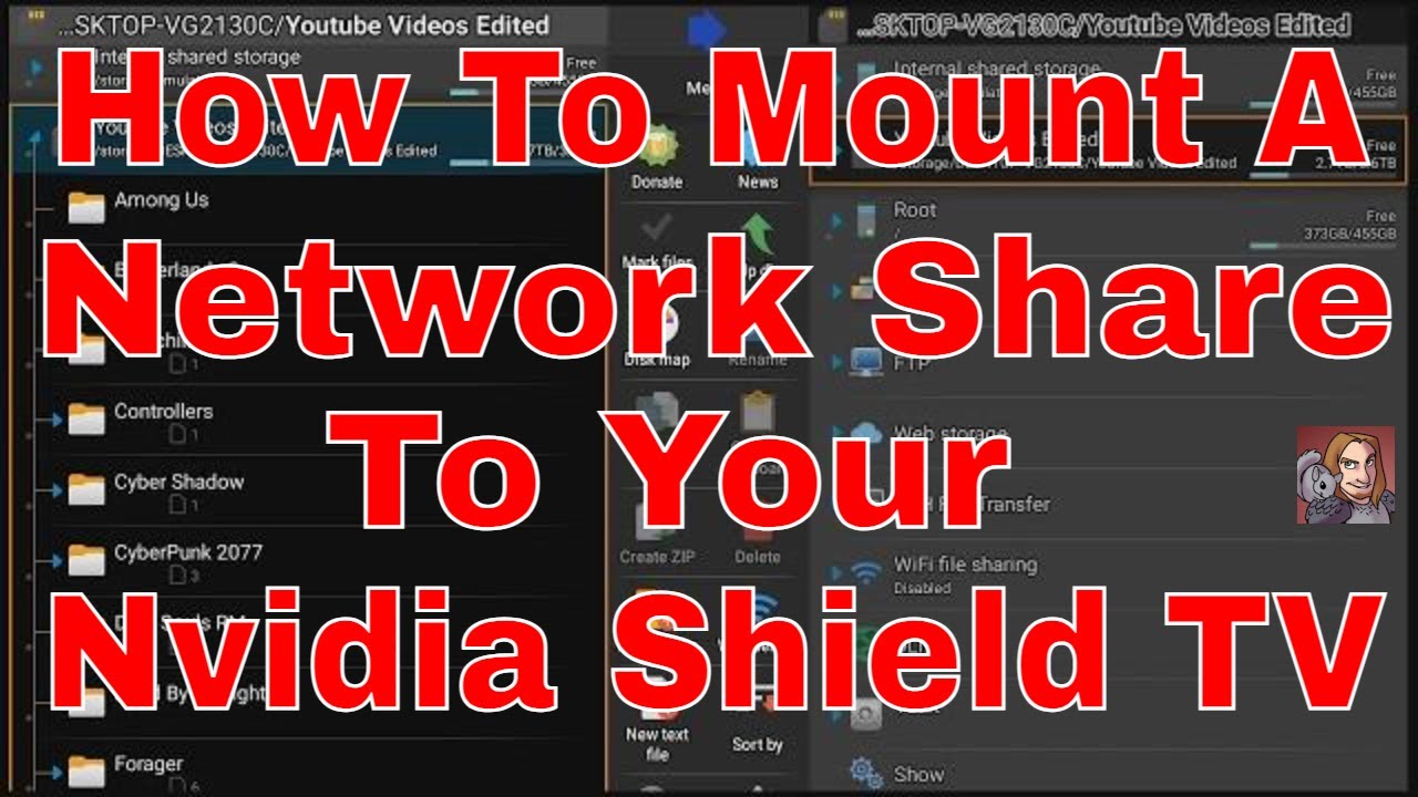

To use your NAS as a media storage for your shield, you need to “mount” the SMB file share(s).
This is covered in the documentation of the shield.
You also might want to take a look at this: How to Setup a Plex Server on the Nvidia Shield TV with External Storage - YouTube
as well as Low Cost Plex Transcoding Server Setup: NAS + Nvidia Shield! - YouTube

Mounting the network share on the Shield is shown in the second video above.
Ok I was following this guys video (see below) for the SMB stuff. got thru it all except the last part which Ill try later tomorrow as its late. I will need to try and login to my Laptop or a share from the shield to see if all those many many steps worked: ANd Yes I watched Lon.TV’s great video a while back when I was setting it up initially for my Music (back then didnt have any desire for movies/tv/video) so yeah thats a good link as well.
