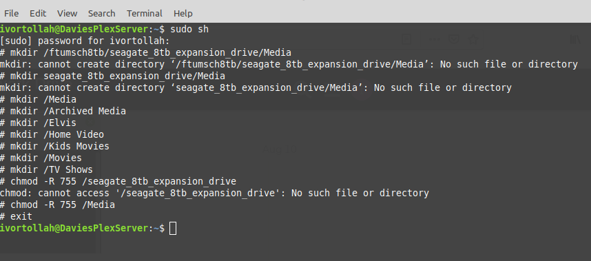

I went on to Step E - “Begin verifying and testing the new mount points” and entered the mount commands as shown:
Screenshot%20from%202019-08-19%2011-10-41
I guess this didn’t work properly and I’ll need to go back to step D?

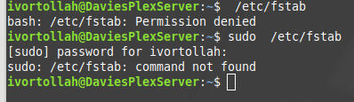

Show me what you put in /etc/fstab please?
Ummm…sorry, I put that (/etc/fstab) in to a terminal command but it came back with “command not found”
Screenshot%20from%202019-08-19%2011-59-44

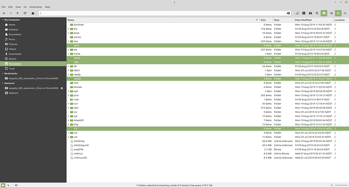

This is a screenshot of the /etc folder contents, there is no /fstab folder:
This is a screenshot of the root directory, the folders from step C have been created here (selected in Green):
Try cat /etc/fstab to display the contents of fstab.
