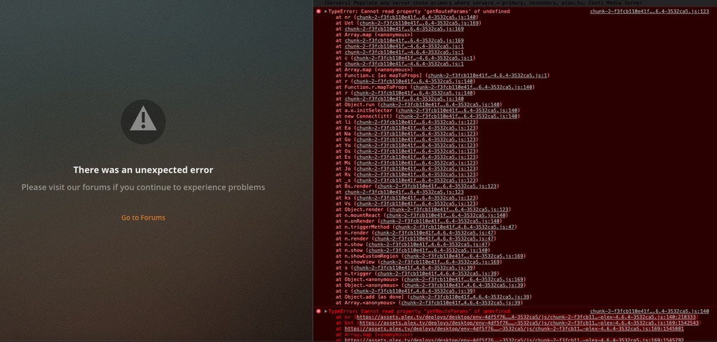

Hey @chrisallen I just noticed an issue that may be related to this build. On desktop browsers and the Mac Player App I get this error when viewing the Live TV section. Worth noting that Live TV works fine on the IOS app.
