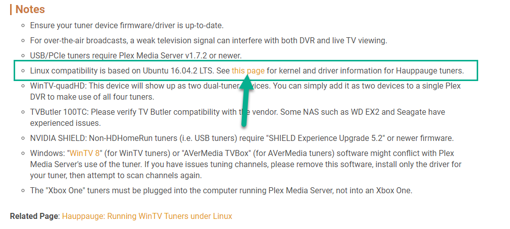

I am not running a Linux PMS and do not have a Hauppauge tuner so can’t offer much more than a couple of points. First, did you look at the note below the supported tuners list? It shows Linux support based on 16.04.2 LTS, from your screenshot it appears you are on 12.04.5 LTS. Second, did you look at the link in the note for Linux it takes you to a Hauppauge support page: http://www.hauppauge.com/site/support/linux.html.
The Hauppauge support page mentions the PPA drivers are supported on 16.04 Xenial with kernel 4.4.
