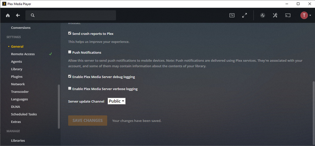

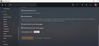

Logs should be Debug checked, Verbose unchecked.

Your logs were in VERBOSE mode which is overkill, uncheck that option.

@mark_cliftonfamily_us , your logs are still in verbose mode.

I just got the I just got Plex 3 pass weeks ago. The only think left is Live TV and the DVR. The logs could help? And a have reset it up multiple times. I even got the latest updatePlex Media Server Logs_2020-03-18_17-55-53.zip (3.9 MB) It shouldn’t be
That is the Player settings, need the server settings.
