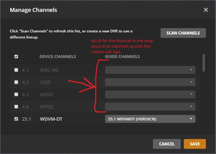

I have a question about adding over the air station ID’s into my Live tv guide. When I scan my live broadcast, I see that I have 21 channels available, but only 10 have guide information for them. Id there a way to enter the other ID manually? In the image below, it shows 4 stations with no information available for the “Guide Channels” and this is preventing me from turning enabling the channel. For example, station 4.1 WRC-HD is an NBC channel but I do not have any universal NBC option in my dropdowns.
Is there any way to correct this or manually add guides to channels?
The drop down menus don’t have the correct information to select from.

Looks like few stations are missing in gracenote database for your zip code. Try different zip code from your OTA market. If you receive channels from another OTA market, try some zip code between the 2 towers.

I was in the same situation as you. I found a zip (postal code for me) that populated all my channels and I reported the issue. I tooks several weeks, but my code is fixed now.

@rouq That worked for me, i played around with other Zip codes and found one that worked :slight_smile:
