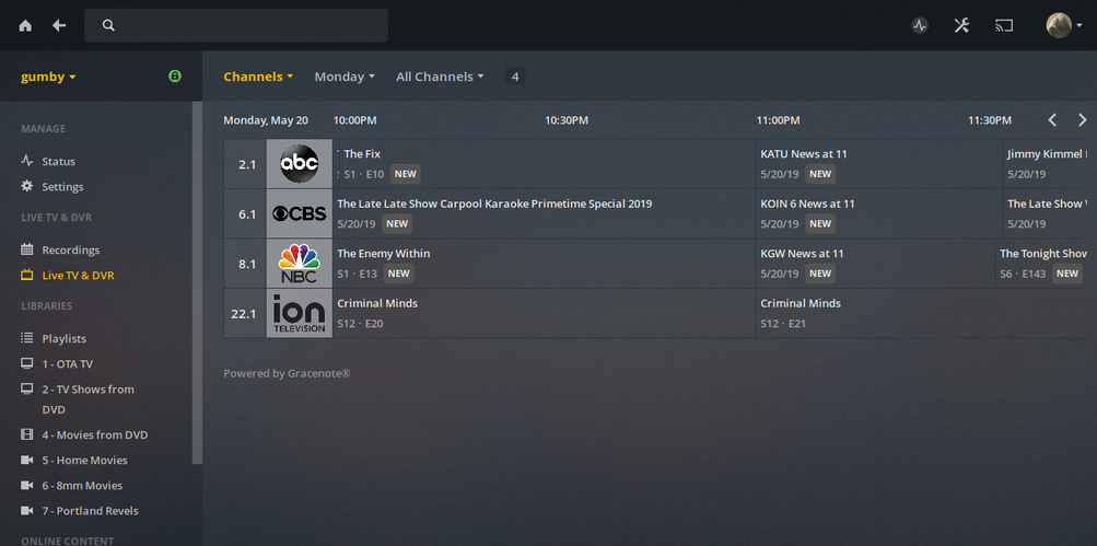

Just setup a new server and guide data is STILL not updating. I have 9 channels active but a week out only 4 show up…

If still a problem, please provide logs again and screenshots showing the enabled channels as showing on DVR Settings page
Sorry. I gave up on Gracenote. I have three plex servers and I’m using Zap2XML on all of them. I get accurate updates all the time without needing to worry that the guide is out of date.
