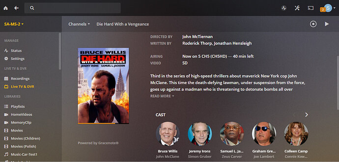

Many thanks for your help and patience. I followed the instructions and all seems to be back to normal. I have set plex to record a TV show and that will be the final test. As an aside, previously when I asked Plex to show me movies to be broadcast (from the dropdown menu) it provided information including a graphic for the movie and portraits of the main actors. Both these are now just blank. It is not critical but more pleasant with the graphics. If it is a setting could you let me know. Once again thank you for your help and I am glad the support matched a very good product.
Michael Flaherty
Did the Guide Refresh complete to 100% ? You could do another manual guide refresh and then collect the logs on completion
Are you referring to these screens. Clicking on the title of the episode on the Grid view
which would then show the following
