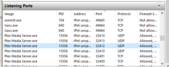

thanks man. I ran the command and nothing happened. i checked the resource monitor and don’t see a listing for it unfortunately. i did just rebooted my pc (just a desktop, not a server)
again, worked earlier/last week, not sure if a server update broke something…
Here’s a screenshot:

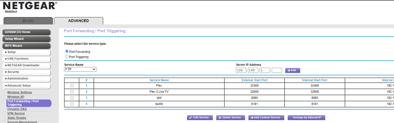

I just tried opening port 32600 on my router and rebooted it. working fine now! so strange…
Wow, I could write a long post about how many ways that makes no sense me - but glad it is working!
Hi, can you tell me how you opened port 32600 on your router? I don’t understand why this is failing since the July 22 version, which worked fine…
I don’t even know that opening this port helped, it might’ve just been my tuner giving issues, but it can’t hurt right? You just need to go into your router settings and setup the port forwarding, the same way you would for plex remote access. Use TCP/UDP protocol, tell it what port and select your pc as the ip address. here’s a screenshot of my setup, on a netgear router (http://routerlogin.net/). not sure if it helps:
