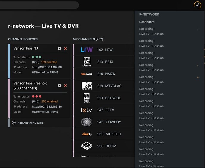

at least a couple times a week i cant watch live TV without restarting the plex server running on my synology box. if i look at activity when its happening, all of a sudden there are a ton of Recording: Live TV - Sessions, but i know this are orphans. is there a way that these can timeout or something… this has been happening more an more in the last few releases for sure.
here is a screenshot of what it looks like when this happens.

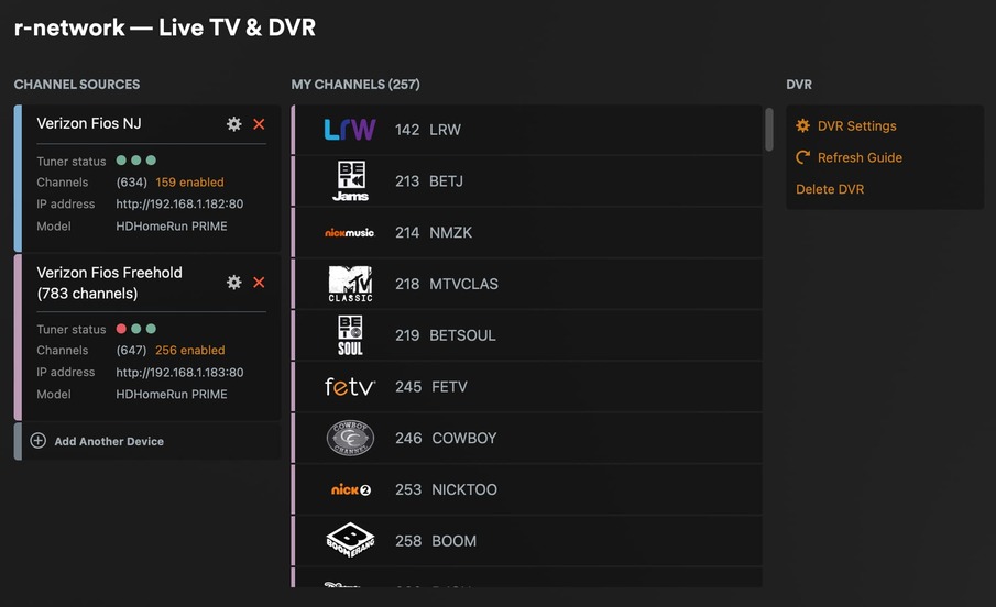

also here is my setup with the HDHomeruns.. when i looked just before the restart, 3 of the 6 tuners were occupied..

What time was the screenshot taken ? And what time was the issue replicated?
Ah - I see the filename of the screenshot shows it was captured at 21:22:31 - I have the logs for this time
OK - I can see the multiple tune requests. Starting a DVR live TV session on a channel and cancelling it when switching to another is not an instantaneous action and I can understand why it may arise that we end up with apparently several sessions in progress - is the problem that the issue does not resolve itself, given it time to complete all the asynchronous actions relating to starting and cancelling DVR Live TV tuning ?
