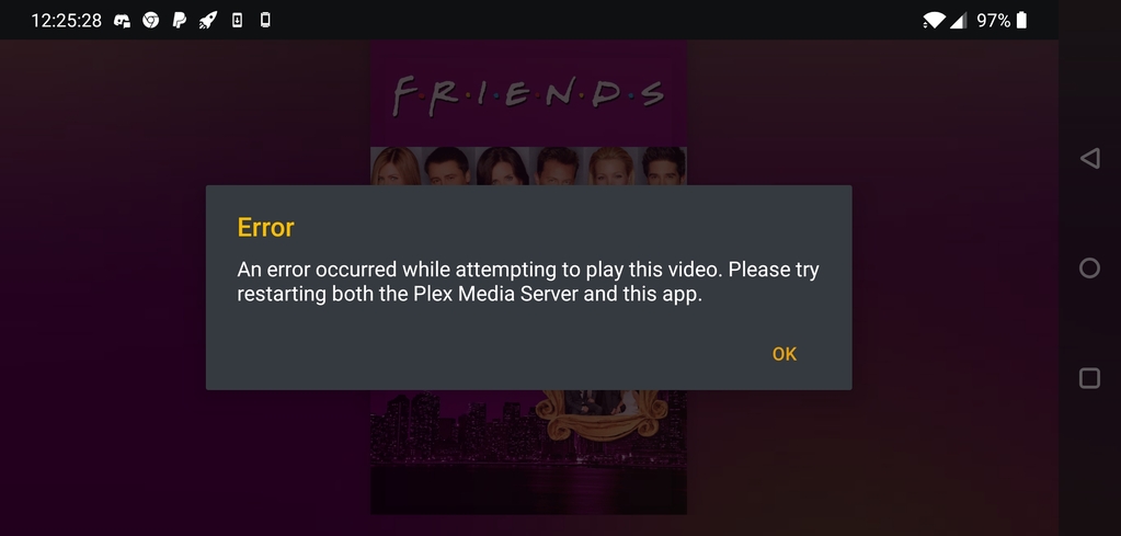

Under Android, on my OnePlus 6T, I am unable to stream live TV or play back recordings from live TV on only certain channels. Some channels will stream and play back perfectly fine, while others will fail with the following error:

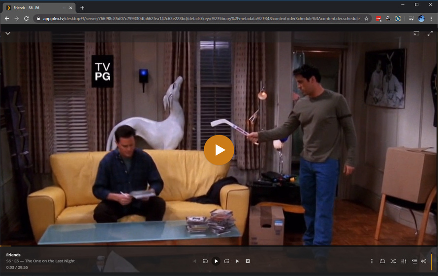

However, I can stream live and watch recorded episodes from all channels on the web version of Plex, including the stations that would trigger an error under Android. Here is the same recorded TV episode that failed to play on my OnePlus 6T, but works correctly in the web client:

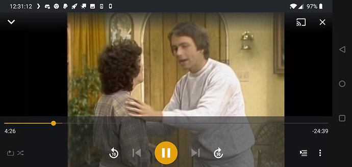

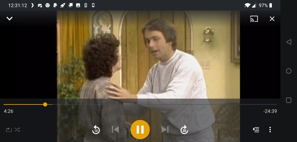

However, tuning to a different station will stream live and play back recorded content fine under both my OnePlus 6T and the web:
