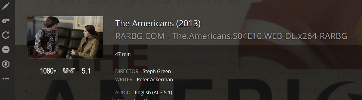

Screenshots attached, but I’m not sure if this is what you want. It basically appears everywhere.
!(https://15254b2dcaab7f5478ab-24461f391e20b7336331d5789078af53.ssl.cf1.rackcdn.com
/plex.vanillacommunity.com/editor/6r/iazbrhu2tj7i.png “”)
Settings>Server>Agents>Shows, I have Local Media Assets (TV) at the top of each, closely followed by TheTVDB where it’s an option.

can I see the ‘info’ tab with the file name too?
I sent along three shots, so you cold see all the data there, just in case.
I also attached the meta data file you see when you click View XML from the info window. I renamed it .txt as XML files won’t post.
Thanks!
Brian
Puzzling. The xml indicates that it is really asking thetvdb. so something must come from the local media assets agent.

Except that that’s not the spam. This is: RARBG.COM - The.Americans.S04E11.WEB-DL.x264-RARBG
That’s what shows up as the title of the show and I can’t find it anywhere.

I see no other explanation for the behaviour yoiu are seeing than this:
either one of your metadata agents was modified or your internet connection is monitored and some software inserts the spam whenever Plex queries for new metadata over the internet.
Have you ever installed a modified metadata agent?
Have you ever used some 3rd party media manager software which might have installed its own metadata agent into Plex (there is at least one which does that)?
Please go through the Plug-ins folder within the Plex data folder (not the one within the plex program folder, which has some hexadecimal code appended to its name).
It should contain a *****.bundle folder for every metadata agent, scanner and channel that was ever installed into your plex.
Look out especially for bundles which have similarly named siblings in the program folder (those are the agents installed by default).

I looked under each and found \seasons\4\episodes\ under each. There was a 11.xml file in each. The episode I am working with now is season 4 , episode 11, so this seemed to the right place.
In the 11.xml files, most contained very little. the one for com.plexapp.agents.thetvdb is attached at a TXT file (.xml not allowed for attachments) and it has Dinner for Seven, which is the correct title for the episode.
Under com.plexapp.agents.localmedia, file attached as 11 (com.plexapp.agents.localmedia).txt, there is RARBG.COM - The.Americans.S04E11.WEB-DL.x264-RARBG
So, this wold seem to indicate that the data is coming from a local media source, right?
I’m no expert on this, but everything I see seems to me to be pointing right back to the file itself. What do you think?
Yes, this certainly indicates that the spam comes from the Local Media Assets agent, which only reads embedded metadata.
